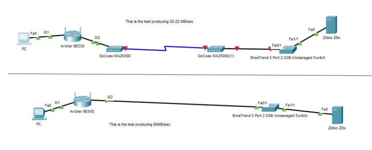

-"So, if i understand the original post correctly" - One moca modem connected directly to the router and one connected into the switch with coax between them.
-See picture for both test scenarios.
-In both test cases I was copying the same file from the same place to the same destination. A huge .mkv file from PC to Zidoo Media Player via Samba drive mapping through Windows Explorer drag/drop.

The thing is though even if the switch is still in line, and the only things changed is the 2 mocas and coax cable for the ethernet cable, data transfer speeds are fine. It's only drops when the moca devices are introduced regardless if a switch is inline or not. And it drops to a silly, low speed.

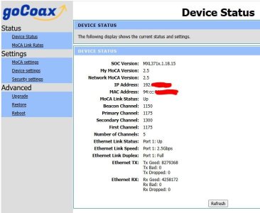

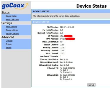

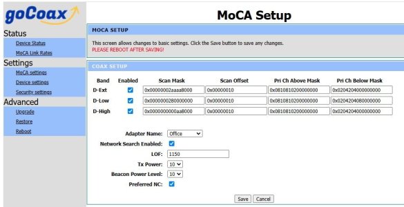

Here are screen shots of the two moca adapters in my testing. Anything else worth noting. I can't run my iPerf tests yet but I will post that info when I can.

There are 3 MoCA devices on my home network although I just grabbed the screenshot just now, only two used in testing and the rates were about identical. Also, these run in full duplex, as I know you mentioned earlier that they might be in half duplex.
