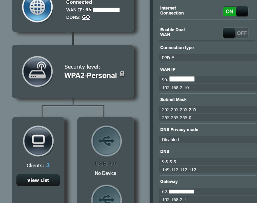

Are you sure your RT-AC86U has a public IP address and that you're not behind some for of NAT (check it at the top of the Network Map page)? Do you have IPv6 enabled for the WAN?
You are NATed. Your WAN IP address is 192.168.x.y which is a private address not a public one.
So GRC is probing whatever device it is that connects you to the public internet.
What device is the RT-AC86U's WAN port connected to?

Modem (a Huawei bridge optical HG 8240T to be exact) is there (ISP equipment). But, I (only) suppose that this is transparent, and finally router is taking care of incoming packets.
Indeed, all online tests/sites are reporting the public address (which I suppose is normal); and of course the public address is different from the lan-side IP addresses of router and modem (as in previous screenhots).
So, public address is (e.g.) 95.200.200.200; modem's lan-side address is 192.168.100.1; router address is 192.168.100.2.
Public address is the one relayed to the web.
Lan-side router address is 192.168.1.1, and devices follow .
But this is (I suppose) a typical scenario.

Anyhow, ASFAIK, all modems provide an "internal" private address to the router downstream (e.g 192.168.100.2). Standard practice.
That's true, but it's common practice for a "bridged" connection to also present the public IP address to the customer's router. This is how cable modems work. A similar principle applies to ADSL/VDSL modems with PPPoE connections.
Just curious, who is your ISP?
But in your case it's more than that. All your traffic is routed through that network, so it is not bridged. The firewall is running in front of your router.
