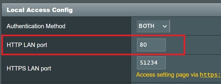

Just to be absolutely sure:
Are you referring to the "HTTP LAN Port" setting on the "Administration - System" WebGUI tab?
If yes, then as far as I can remember, that port setting has always been visible and still is on the latest F/W versions. The input field is also editable but I've never had a reason to change it from its default setting. And no, nothing has been done to the JavaScript/ASP/HTML code for that webpage to make the field visible & editable.
Here's a screenshot from the RT-AC86U running 386.11 F/W:
Here's a screenshot from the RT-AX86S running 3004.388.4 F/W:
If that's not what we're talking about here, which is the field that it's not supposed to be visible & user-configurable on the webGUI?

That field is not supposed to be visible. Are you using some trick to make it accessible? If so, that's your problem, that port is not intended to be user-configurable.
No, I am not using any trick, using firmware 386.11. Other ports are working, I tried 79 and 8080.

I don't remember about 386.11, but in 386.12 that field is marked as hidden at the HTML level, and the code to display it only does so if the firmware lacks HTTPS support.

It's probably an error in the GUI logic. Reenable SSH access. Then SSH into the router and issue these commands:
nvram set http_lanport=80
nvram commit
service restart_httpd

Thank you, that did work. Unfortunately I cannot switch off SSH anymore, because as soon as I want to switch SSH to off I get an error "(80) This port is for: HTTP LAN port". I feel like this is a continuous loop....
I switched to port 79 and I was successfull to disable SSH. But port 79 didn't work after that, it reported as an ERR_UNSAFE_PORT. Switching to 8080 made it work again, but getting back to port 79 kept saying ERR_UNSAFE_PORT. Tested on 2 browers Brave and Edge (so it's not browser dependend).
ERR_UNSAFE_PORT: Port 79 is one of the ports that browsers block. Try using port 81.
