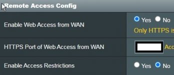

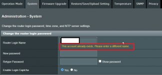

Please advice. I want to change the port number for WAN access but after changing the port number I have a problem - this account already exists ... Can anyone try it? well thank you
This has been reported before. It's not specifically about the port change, but changing anything on that page generates the error. It seems the user accounts got corrupted when upgrading from 384 to 386. A factory reset and manual configure should sort it out.

OK thanks for the reply. It is true that I went from 384 to 386. I wanted to test my previous problems with PPPoE connection on versions 386... 384_19 has been working well for several weeks. I made an update 3 days ago and everything works there. So I'll try the factory settings ...
I changed a couple things on that page after going from 384 to 386 and I didn't have this problem. I enabled and disabled SSH. I also disabled and enabled LEDs.
