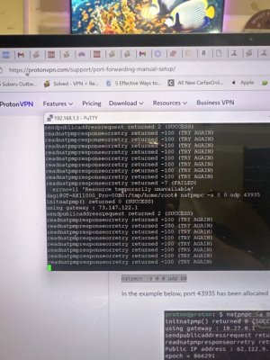

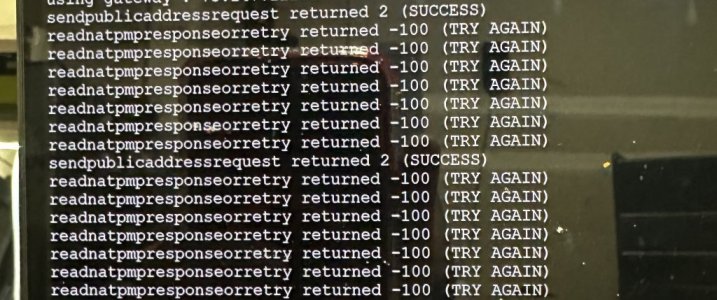

Thank you I keep getting this error when I run natpmpc could command
There's no such thing as natmapc, you probably mean natpmpc.
Install Entware then:
opkg install natpmpc
Thank u you so much. I have my VPN on. How do find my default gateway for my VNP
It depends how your VPN is configured. The easiest way is to look at the router's VPN Status page and find the Local IP of the tunnel. If it says something like "10.8.3.2" then the gateway address is probably "10.8.3.1".
