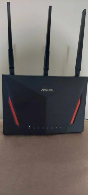

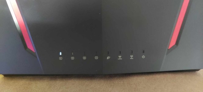

Hello, I have an ASUS RT-AC86U that I've been running the latest Merlin version on (386.12). About the beginning of October, I get home from work and I noticed that my WiFi wasn't working. I go to my router and noticed that the only light lit is the LAN 4/Port 4 (my apologies if I'm not using the correct terminology, I'm a little rusty when it comes to that - I am also including pictures to show the only light lit on the router itself). I tried to unplug the router for a while, but nothing. I couldn't even access the router with my laptop hardwired into it (ethernet cable).
Common hardware failure for this model. A voltage regulator chip burned inside the router.

Component U335 needs to be replaced, step-down voltage converter, MT3125. Surface mount 3x3mm IC for about $1.50 + shipping from China. If nothing else burned with it the router will come back alive.
