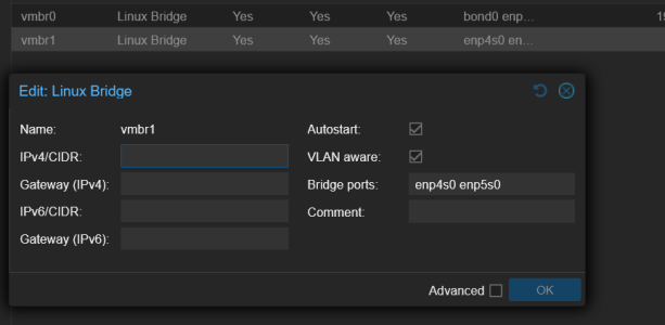

Trying to get Smb multichannel to work on my Proxmox server. The Smb server exists on my Ubuntu VM. Anything you notice that might be wrong with this setup? additionally both client NIC's support 2 RSS channels per NIC. The server can support up to 4 RSS channels per NIC (Windows only supports up to a max of 4 channels). SMB server uses mandatory signing and mandatory encryption SMB 3
Proxmox network bridge:
server multi channel support = yes
VM network adapters: vmbr0 has a gateway; vmbr1 is two network adapters directly connect from server to client binded to smb. Ubuntu network adapters for smb are set to Link-Local so that Windows 11 handles the DHCP.

My current assumption is that because the clients are on 169.254.144.194 & 168.254.184.58 and the server is on 169.254.83.90 & 169.254.232.175 they are using different subnets so maybe that’s the problem. Well these dhcp addresses were auto assigned maybe I need to put everything in the same subnet? I read Linux should use different subnets for smb multichannel.

So I've further isolated each physical link into two bridges since I last posted.
Layout looks like this. Ignore vmbr0 as it's just so I can access management of proxmox. Well it's detecting RSS channels it's not actually using them or the other NIC. 169.254.83.90 is the mapped drive ip on windows. Vlan is aware on each bridge, but both are using vlan0. I had each interface in one bridge before, but I didn’t want crosstalk within the same bridge, this way it’s more representative of what baremetal would be. Each Nic client and server have both 2 set for RSS channels in each Nic.

Sorry maybe I wasn’t clear there is 4 total physical NICs involved 2 for server, 2 for client. The virtual NICs are simply to used to connect to the VM.
I'm going to just complicate the post more since I've changed the layout of my configuration again bringing them into the same subnet as my router. I've been attempting to troubleshoot through trial and error. Everything above is the same except I've attempted to route through the router, but I intend to change it back to how it was later. The smb.conf is the same except for the IP address's. I agree code is better, but their was post limitations in word count so I went with photos.
