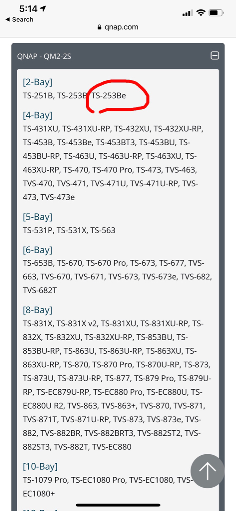

I've just purchased the QM2-2S card for my TS-253Be and I'm just wondering if anyone here has installed it or the pricier QM2-2S10G1T (edit : not compatible) or QM2-2P10G1T with 10 GbE Network port. Have you found significant performance increases as advertised? I chose the cheaper option as I don't really have a need at this time for the ethernet port.

The QM2-2S is neither, I checked the compatibility list again, and it's compatible.
See here:

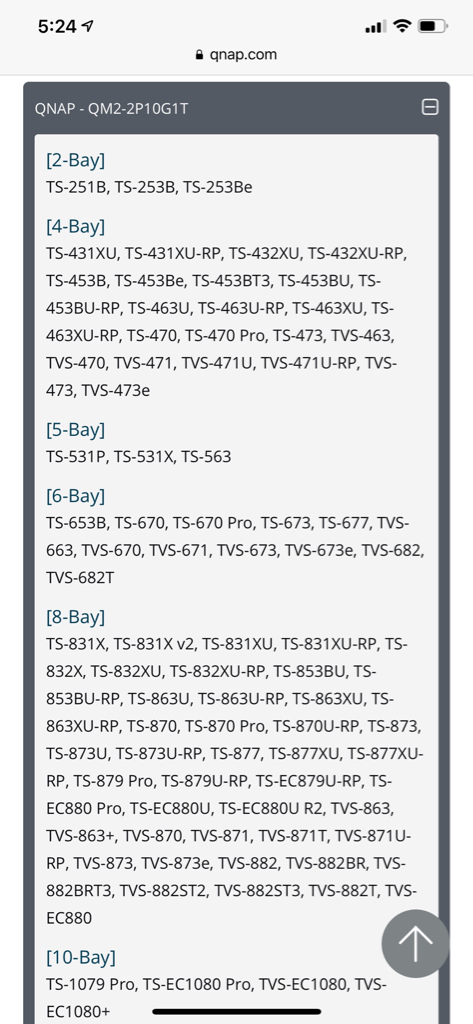

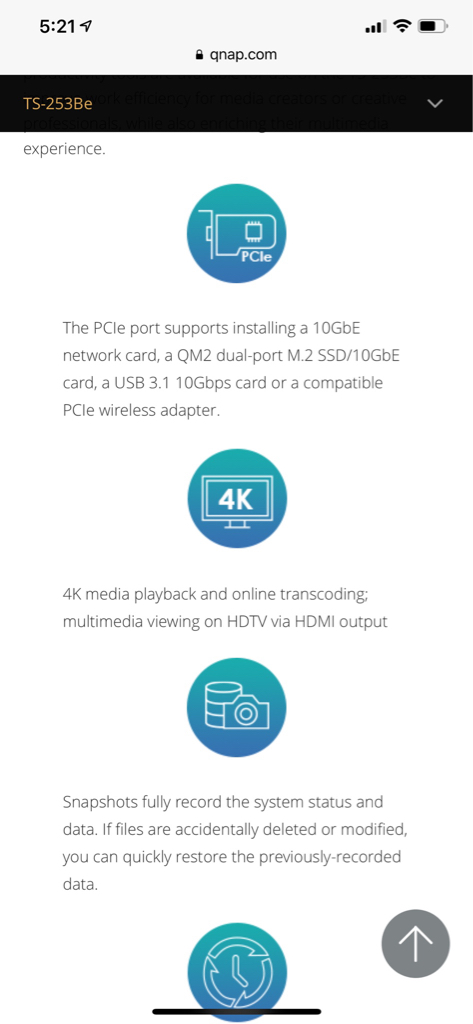

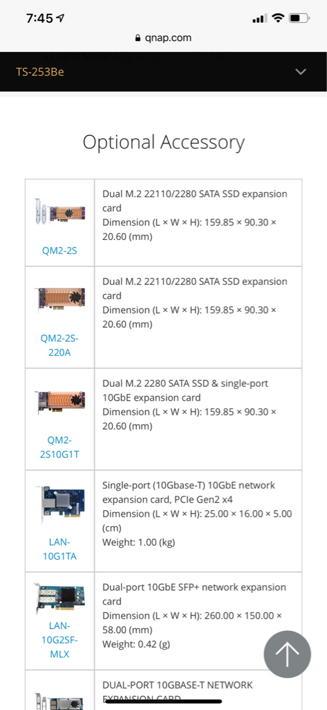

Also for the 10GbE version (QM2-SP10G1T) is compatible according to the QNAP site:
Although, this appears to contradict the QNAP compatibility list concerning the QM2-2S10G1T and the QM2-2P10G1T (but it doesn't contradict the one I've purchased, the QM2-2S):
I have emailed support for the clarification.
