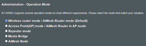

Almost all wireless routers can be configured to run in "access point mode". Not rare at all. The problem with using access point mode is that it just extends your main wireless network and therefore doesn't offer any separation. So in your case it's better to operate in "wireless router mode".
Here's the configuration screen from my Asus router but other makes will have something similar.
