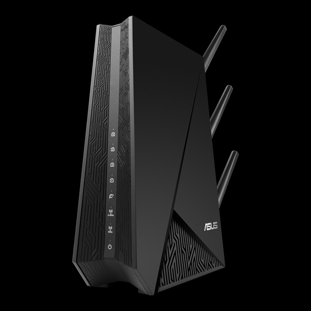

RP-AC68U ≠ RP-AC1900, they are actually different. however, because RP-AC1900 is a new model, wikidevi has no information yet, but I believe it uses the BCM4708/4709 CPU.
BTW, I don't like this new shape, they are going backwards, not even as good as RP-AC68U.
This is RP-AC68U:
This is RP-AC1900:

So here is my update.
1) The mesh will setup when using my RT-AC68U with latest Merlin firmware and latest ASUS firmware for the RP-AC1900
2) mess works, but will not connect with 5ghz devices. Started tech support help with ASUS
3) did restore my RT-AC68U to latest ASUS firmware and re-setup mesh. Both devices using Asus firmware. Did not help 5ghz issue.
4) loaded Merlin firmware back onto RT-AC68U and then on the RP-AC1900. Both booted and I was able to setup mesh.
5) still have the 5ghz no connect issue, but the RP-AC1900 works just as well as the original ASUS firmware.
So with that a said. now i need to find out why RP-AC1900 will not connect with 5ghz devices. LAN ports work fine.
so final update on my adventure. As with a lot of ASUS products, they really are not clear on how they do stuff. What i found out was when you connect a mesh node to the router, the node uses the 5ghz radio. So all devices at the node will connect to the 2.4ghz radio. There is no way to change this. So if you need both radio channels then the only way to do this is with the backhaul connection method.
Since early on i was able to use that same Merlin firmware that I had installed on router, i am going to up date with Merlin firmware since mesh node functioned correctly and had no connection issues. It looks like the RP-AC1900 is a RT-AC68U in a plastic case.
No issues encountered while flashing mesh node with latest Merlin firmware.
