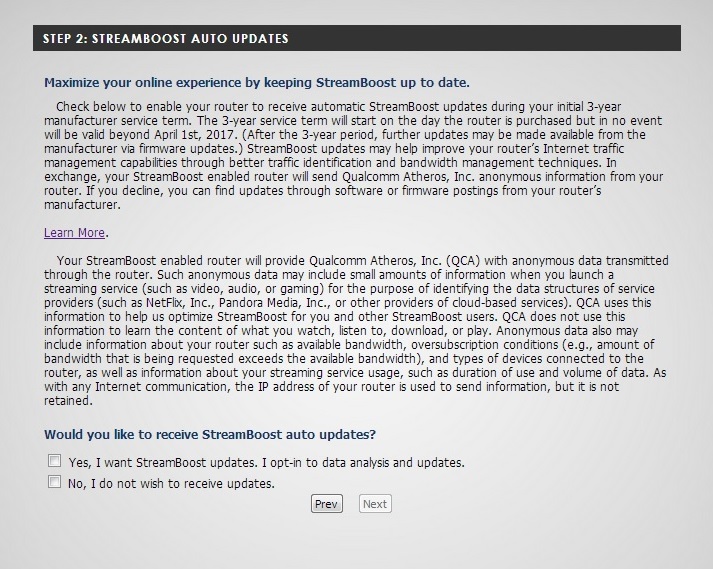

The problem is that QoS tries to reach the site updates.r7800.netgear.streamboost.yeti.bigfootnetworks.com (this URL, probably QCA, is assembled when you click "Update QoS") but no such site anymore. Maybe NG is not interested in continuation of QoS DB update for R7800 (EOL?).

Hi @Voxel ! Of course it is not you. I tried latest official fw and i have the same behavior.
I agree that it seems updating streamboost for R7800 reach an EOL condition. (=NXDOMAIN)

Something you might ask NG or NetGearGuy about and see what the status is for the R7800. Possible that QoS DB has met EOL. Since the R7800 is getting up in age now.

Take a look here for a little bit of insight regarding BigFoot Networks and StreamBoost:
https://www.smallnetbuilder.com/lanwan/lanwan-features/32297-does-qualcomms-streamboost-really-work
It never worked well on D-Links DGL-5500 sad to say. What a roller coaster ride that was. QCA was very bad in development of SB and keeping it working well. Never again. :mad:
