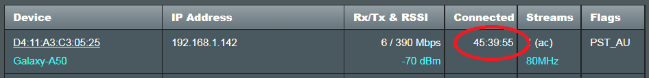

Yes, it's supposed to work seamlessly.
It does work seamlessly:
Jan 10 12:36:37 hostapd: eth7: STA dc:53:60:84:45:6d WPA: group key handshake completed (RSN)
Jan 10 12:36:37 hostapd: eth6: STA b0:05:94:25:d8:b3 WPA: group key handshake completed (RSN)
Jan 10 12:36:37 hostapd: eth6: STA b4:7c:9c:50:81:bf WPA: group key handshake completed (RSN)
Jan 10 12:36:37 hostapd: eth6: STA a8:6b:ad:4d:3e:4a WPA: group key handshake completed (RSN)
Jan 10 12:36:37 hostapd: eth7: STA 64:6e:69:2b:c8:0d WPA: group key handshake completed (RSN)
Jan 10 12:36:37 hostapd: eth7: STA d4:11:a3:c3:05:25 WPA: group key handshake completed (RSN)
Jan 10 12:36:37 hostapd: eth7: STA d4:38:9c:ba:dc:30 WPA: group key handshake completed (RSN)
Jan 10 12:36:38 hostapd: eth7: STA ec:1f:72:f8:4a:21 WPA: group key handshake completed (RSN)
Jan 10 13:36:37 hostapd: eth7: STA dc:53:60:84:45:6d WPA: group key handshake completed (RSN)
Jan 10 13:36:37 hostapd: eth6: STA b0:05:94:25:d8:b3 WPA: group key handshake completed (RSN)
Jan 10 13:36:37 hostapd: eth6: STA b4:7c:9c:50:81:bf WPA: group key handshake completed (RSN)
Jan 10 13:36:37 hostapd: eth6: STA a8:6b:ad:4d:3e:4a WPA: group key handshake completed (RSN)
Jan 10 13:36:37 hostapd: eth7: STA 64:6e:69:2b:c8:0d WPA: group key handshake completed (RSN)
Jan 10 13:36:37 hostapd: eth7: STA d4:11:a3:c3:05:25 WPA: group key handshake completed (RSN)
Jan 10 13:36:37 hostapd: eth7: STA d4:38:9c:ba:dc:30 WPA: group key handshake completed (RSN)
Jan 10 13:36:38 hostapd: eth7: STA ec:1f:72:f8:4a:21 WPA: group key handshake completed (RSN)
Jan 10 14:36:37 hostapd: eth7: STA dc:53:60:84:45:6d WPA: group key handshake completed (RSN)
Jan 10 14:36:37 hostapd: eth6: STA b4:7c:9c:50:81:bf WPA: group key handshake completed (RSN)
Jan 10 14:36:37 hostapd: eth6: STA b0:05:94:25:d8:b3 WPA: group key handshake completed (RSN)
Jan 10 14:36:37 hostapd: eth6: STA a8:6b:ad:4d:3e:4a WPA: group key handshake completed (RSN)
Jan 10 14:36:37 hostapd: eth7: STA 64:6e:69:2b:c8:0d WPA: group key handshake completed (RSN)
Jan 10 14:36:37 hostapd: eth7: STA d4:38:9c:ba:dc:30 WPA: group key handshake completed (RSN)
Jan 10 14:36:37 hostapd: eth7: STA ec:1f:72:f8:4a:21 WPA: group key handshake completed (RSN)
Jan 10 14:36:38 hostapd: eth7: STA d4:11:a3:c3:05:25 WPA: group key handshake completed (RSN)
