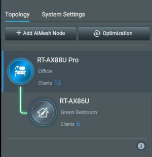

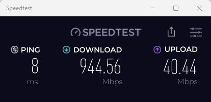

FYI - I upgraded my AX86U to the AX88U-Pro and now use the AX86U as a mesh device. I too was offered 1 Gb from my ISP and took it. As primary router, the AX88U-Pro gives me 944 Mbit / 40.4 Mbit consistently on speed tests without VPN (But all AI protections are enabled). So it should give you pretty decent speeds with VPN enabled. Using the 86U as a mesh device has greatly improved my experience with devices located far away from my primary router. Seems to be a great setup for me.
