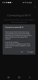

At the moment I am trying to connect a Nano Leaf panel and Lenovo smart clock. Both devices do connect to the network but the phone isn't able to access them. It recommends having AP isolation disabled which it is. I have these devices on the network but with no way to access them

Thank you all for your advice - I did a factory format - format Jiff - use Guest network 2 and disabled the following
Please see below
Unfortunately, I get the same error message
I currently connect to my guest network on my phone to communicate with the IOT devices.

While I'm good at being stupid at times, it would seem to me that the initial situation could have arisen from "Access Intranet: Disabled". That setting would have prevented the device you were using to set up the IoT devices from being seen! If you switch to using YazFi, you'll at least need to allow full intranet access (with the phone you use for the setup logged into the same guest WiFi) while you set the IOT devices up. Once set up, you can flick intranet access switch to a suitable setting.
As I said I'm good at being stupid, being wrong, and reading what I want to read, rather than what's been written...
Interestingly enough, on my initial setup, I did have it enabled but had the same error message. After the factory reset and changes above were made, enabling it did work! Thanks man. I think I'm going to look into using YazFi as well. Looks like it gives a ton of more control.
