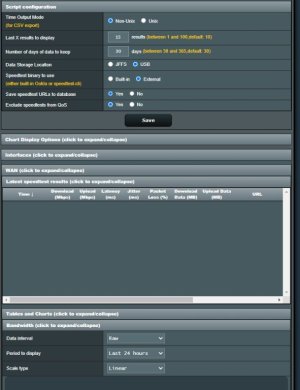

I have fully reset my AX86U... do all the setup from scratch... and I can't figure out why results are not showing up.
I did a DB reset and still not seeing results. I've forced reinstall and still empty on WebGUI.
Any workaround to make it work like before? I'm having BW problem with my ISP and it'll be perfect to show them all the automated test results.
Thanks,
I'm using latest Chrome version, and your latest spdmerlin client.

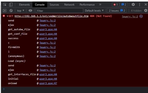

This:

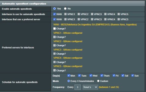

I doubt you missed it but essential settings I can't see in your pic are "Enable automatic speedtests" >yes and make sure you check the two settings directly below are set to the interface you want to test.
this looks like the suspect line: View attachment 48986
So, what do you suggest me doing? sorry.
I have it setup as WAN-Preferred Server-Every day-Every 3hours-Store on USB (I have done all these using SSH)
I've never installed & used spdMerlin on my router so I'm not familiar with it at all; however, I have become fairly familiar with the WebGUI template/framework that @JackYaz uses for his add-ons, and given that the screenshot of your browser console shows what appears to be a missing file, I'd suggest providing the output of the following commands as one more troubleshooting step:
Bash:
   echo "$(readlink -f /www/user)"
   ls -AlF "$(readlink -f /www/user)/spdmerlin"
   echo
   echo "/jffs/addons/spdmerlin.d"
   ls -AlF /jffs/addons/spdmerlin.d
   echo
Just my 2 cents.
Bash:
   echo
   echo
Just my 2 cents.
sentinelvdx@RT-AX86U:/tmp/home/root#    ls -AlF "$(readlink -f /www/user)/spdmerlin"
lrwxrwxrwx    1 sentinel root            37 Mar 31 09:00 autobwoutfile.htm -> /opt/share/spdmerlin.d/.autobwoutfile
lrwxrwxrwx    1 sentinel root            29 Mar 31 09:00 config.htm -> /opt/share/spdmerlin.d/config
lrwxrwxrwx    1 sentinel root            26 Mar 31 09:00 csv -> /opt/share/spdmerlin.d/csv/
lrwxrwxrwx    1 sentinel root            22 Mar 31 09:00 detect_spdtest.js -> /tmp/detect_spdtest.js
lrwxrwxrwx    1 sentinel root            39 Mar 31 09:00 interfaces_user.htm -> /opt/share/spdmerlin.d/.interfaces_user
lrwxrwxrwx    1 sentinel root            38 Mar 31 09:00 lastx_VPNC1.htm -> /opt/share/spdmerlin.d/lastx_VPNC1.csv
lrwxrwxrwx    1 sentinel root            38 Mar 31 09:00 lastx_VPNC2.htm -> /opt/share/spdmerlin.d/lastx_VPNC2.csv
lrwxrwxrwx    1 sentinel root            38 Mar 31 09:00 lastx_VPNC3.htm -> /opt/share/spdmerlin.d/lastx_VPNC3.csv
lrwxrwxrwx    1 sentinel root            38 Mar 31 09:00 lastx_VPNC4.htm -> /opt/share/spdmerlin.d/lastx_VPNC4.csv
lrwxrwxrwx    1 sentinel root            38 Mar 31 09:00 lastx_VPNC5.htm -> /opt/share/spdmerlin.d/lastx_VPNC5.csv
lrwxrwxrwx    1 sentinel root            36 Mar 31 09:00 lastx_WAN.htm -> /opt/share/spdmerlin.d/lastx_WAN.csv
lrwxrwxrwx    1 sentinel root            21 Mar 31 09:00 spd-binary.htm -> /tmp/spdmerlin-binary
lrwxrwxrwx    1 sentinel root            19 Mar 31 09:00 spd-result.htm -> /tmp/spd-result.txt
lrwxrwxrwx    1 sentinel root            18 Mar 31 09:00 spd-stats.htm -> /tmp/spd-stats.txt
lrwxrwxrwx    1 sentinel root            38 Mar 31 09:00 spdtitletext.js -> /opt/share/spdmerlin.d/spdtitletext.js
sentinelvdx@RT-AX86U:/tmp/home/root#    ls -AlF /jffs/addons/spdmerlin.d
-rw-rw-rw-    1 sentinel root             0 Mar 29 20:04 .databaseupgraded
-rw-rw-rw-    1 sentinel root         35149 Mar 29 20:05 LICENSE
-rw-rw-rw-    1 sentinel root          3443 Mar 29 20:04 README.md
-rw-rw-rw-    1 sentinel root             0 Mar 29 20:13 lastx_VPNC1.csv
-rw-rw-rw-    1 sentinel root             0 Mar 29 20:13 lastx_VPNC2.csv
-rw-rw-rw-    1 sentinel root             0 Mar 29 20:13 lastx_VPNC3.csv
-rw-rw-rw-    1 sentinel root             0 Mar 29 20:13 lastx_VPNC4.csv
-rw-rw-rw-    1 sentinel root             0 Mar 29 20:13 lastx_VPNC5.csv
-rw-rw-rw-    1 sentinel root           395 Mar 29 20:12 lastx_WAN.csv
drwxrwxrwx    2 sentinel root             0 Mar 29 20:04 ookla/
drwxrwxrwx    2 sentinel root             0 Mar 29 20:04 ooklalicense/
-rw-rw-rw-    1 sentinel root         83917 Mar 29 20:04 spdstats_www.asp
