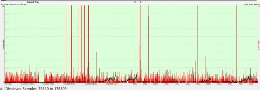

I have three RT-AC68U Version B2 which is really the same hardware as the AC-1900p. While troubleshooting issues with AiMesh I used a program called Ping Plotter to graph many weeks of pings, one per second on the nodes IP addresses. Noticed lots of droppped packets, about 3.5%. And the packet loss is continious, not related to load or internference. Does this with either Merlin or Asus firmware. If I swap node with a older v1 RT-AC68U there is zero packet loss. Starting digging around on this site for answers and came across a review of AC-1900p that gave it a fail score on dropped UDP packets, which makes sense why I see so many dropped pings. Interesting that this mostly happens when configured as a node. When I configure one as a media bridge it much better and acceptable. Havent tested pings if configuring as repeter or single wifi router, just nodes.
Heres the review that mentions UDP - AC1900P review. Attached is 48 hour plot of RT-AC68U v.B2 configured as node, where red is packet loss. (No red on v1 RT-AC68U.)
So as an AiMesh node I really dont like B2 version of RT-AC68U (AKA AC-1900p).
