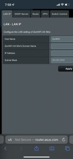

The LAN > DCHP settings are what is sent to DHCP clients. The WAN DNS settings are what the router uses.
Under my routers LAN section, what would be correct. Typing in the IP address of itself/gateway (I.e 192.168.1.1) or just leaving it blank?
Blank
