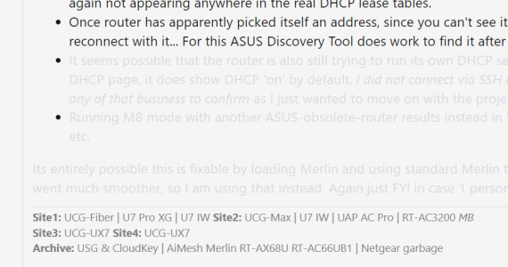

Can you remove the white/grey colour attributes from your text as it makes it nearly invisible when viewed with certain themes. Thanks.
On this thread also? I used no color at all on this one. The only text formatting I used was italics.
OK weird. Yeah there's embedded color tags in there in weird spots. I did NOT put those in. Maybe editor put those in from a cut & paste? But I've never picked white or gray as a color so very strange.
