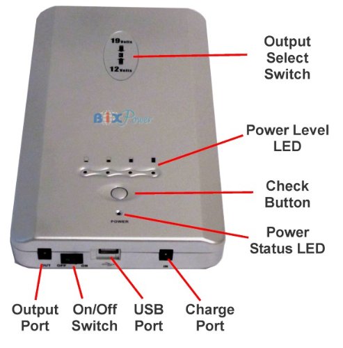

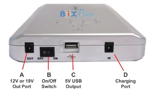

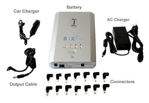

I'm using AC68U with this battery pack since September 2013:
BiXPower 153 Wh (42500mAh) Super High Capacity 12V & 19V External Rechargeable Battery Pack - BiXPower BP160

How long does it keep it powered strictly on battery?
I have seen it go for 8 hours, didn't test beyond that. If I had to guess, about 10-12 hours.
Worth it where the power source is sketchy.

This is (with the exception of the price) kind of what i was looking for. The fact it is not specifically advertised as a (DC) UPS is what doesn't convince me yet since my assumption is that it's not intended specificly to be always connected and the impact it would have on its lifecycle.
I'll seriously think of this one if there are no other available options. I also want to avoid a conventional UPS.
