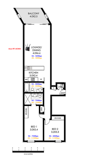

More tests (2-bed apartment):
1m away from the router
5G - iPhone, Speedtest 92 Mbps
2.4G - iPhone, Speedtest 30 Mbps
Around 10m away from the router and 2 walls
5G - iPhone, Speedtest 84 Mbps
2.4G - iPhone, Speedtest 1-2 Mbps

Yes, I replaced RT-AC68U with RT-AC86U. Here is my floor plan with all speeds measured on the latest iPad Pro (Speedtest.net). Strangely enough, 5G performs here better in the longer distance than the 2G?

Speed 30-50Mbps on 2.4GHz is good. Usually 2.4GHz band is busy, hard to get maximum possible speeds. 1-stream N client maximum link speed is 72Mbps, 2-stream clients get 144Mbps. The expected throughput is about half of the link speed. Your router works as expected. All you can do is play with different Wi-Fi channels and find one with more available bandwidth. I can get up to 90Mbps in my house with more quiet Wi-Fi environment, but no more than 40Mbps in my downtown apartment with 20+ 2.4GHz networks around.

As tech9 said 30-50Mbps is what is expected for 2.4Ghz. Maybe you have some interference between the router and the bedroom, 10 meters shouldn't make that big of a difference. Can you try a different location?

N300 is the marketing term for 2-stream N devices. 300Mbps is the maximum link speed @40MHz wide channel in ideal conditions. In theory it can reach 200Mbps throughput, if you live in the middle of a cornfield with no other WI-Fi networks around. Real world performance is much lower.

Available bandwidth on 2.4GHz is low. We have 11x 20MHz channels only in most countries. This is the highway, your router is one car in the traffic. 100km/h speed may be allowed, but not possible most of the time. You are close to the router, but the router sees the other traffic on the highway and has to wait for a gap. 40MHz channel is like hauling an oversized load that takes 6 lanes on a busy highway, slowing everyone further down.
