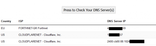

I have rt-ac86u with official fw 3.0.0.4.386_44470.
I set my pihole as dns on dhcp but the devices get 2 dns on network adapter. The first one is indeed pihole and the second is the router's ip address.
When I test each device's dns from this link I see 3 dns entries, my public ip address as I have installed unbound in recursive mode and cloudflare dns(ipv4/ipv6) which is set on router wan dns(1.1.1.1 and 1.0.0.1). I also have ipv6 disabled on router.
The only way devices get only pihole as dns is to manually assign IP and add pihole's ip address in the dns field or manually set pihole as dns on each device's network adapter, something that I don't want to do for each device. That is dhcp intended to do.
I also found this link with no luck.
So is there any solution to this issue?

I'm not sure that clients use primary and secondary dns that way.
Have a look here:
https://discourse.pi-hole.net/t/primary-vs-secondary-dns/1536
So if pihole isn't the only dns some queries will be answered directly from public dns provider(in my case cloudflare). This means that maybe filtering will not function as it is should and unbound in recursive mode, too.
I have not upgraded fw yet because I got the router some days ago and I want to notice current fw performance just to compare with the newer fw.
This is true. Which servers the client chooses to use (from the DHCP-supplied list) from one request to another is down to it's own behaviour. Microsoft for example has published the methods that it uses in different versions of Windows.
As stock firmware always appends the router's own IP address to the list of DNS servers this creates the problem you're describing. The solution therefore is in that link you provided (assuming a recent firmware version). Leave the DHCP-DNS servers blank so that the client is only using the router for DNS. Then set the WAN-DNS to your pi-hole address. Unfortunately this has the effect of the pi-hole seeing all DNS requests as coming from the router rather than the client.
