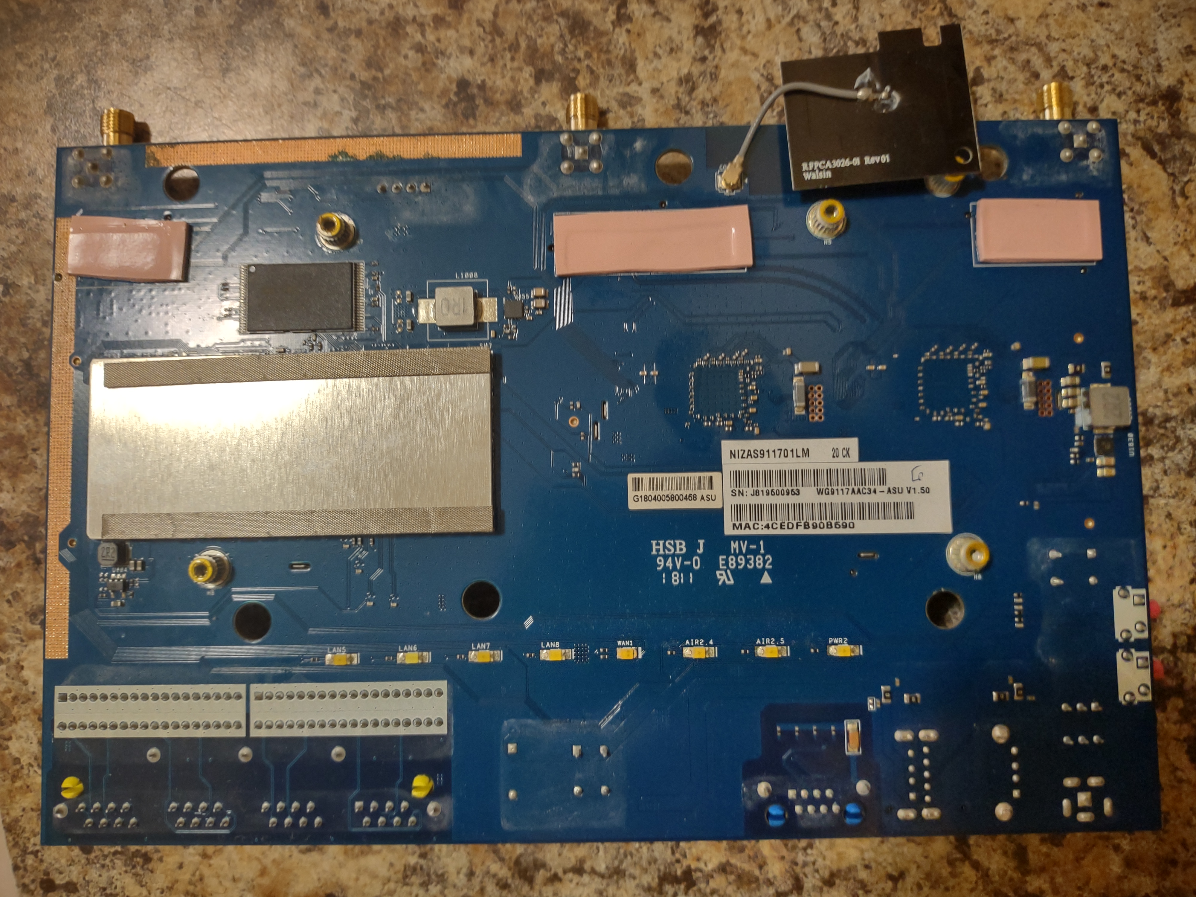

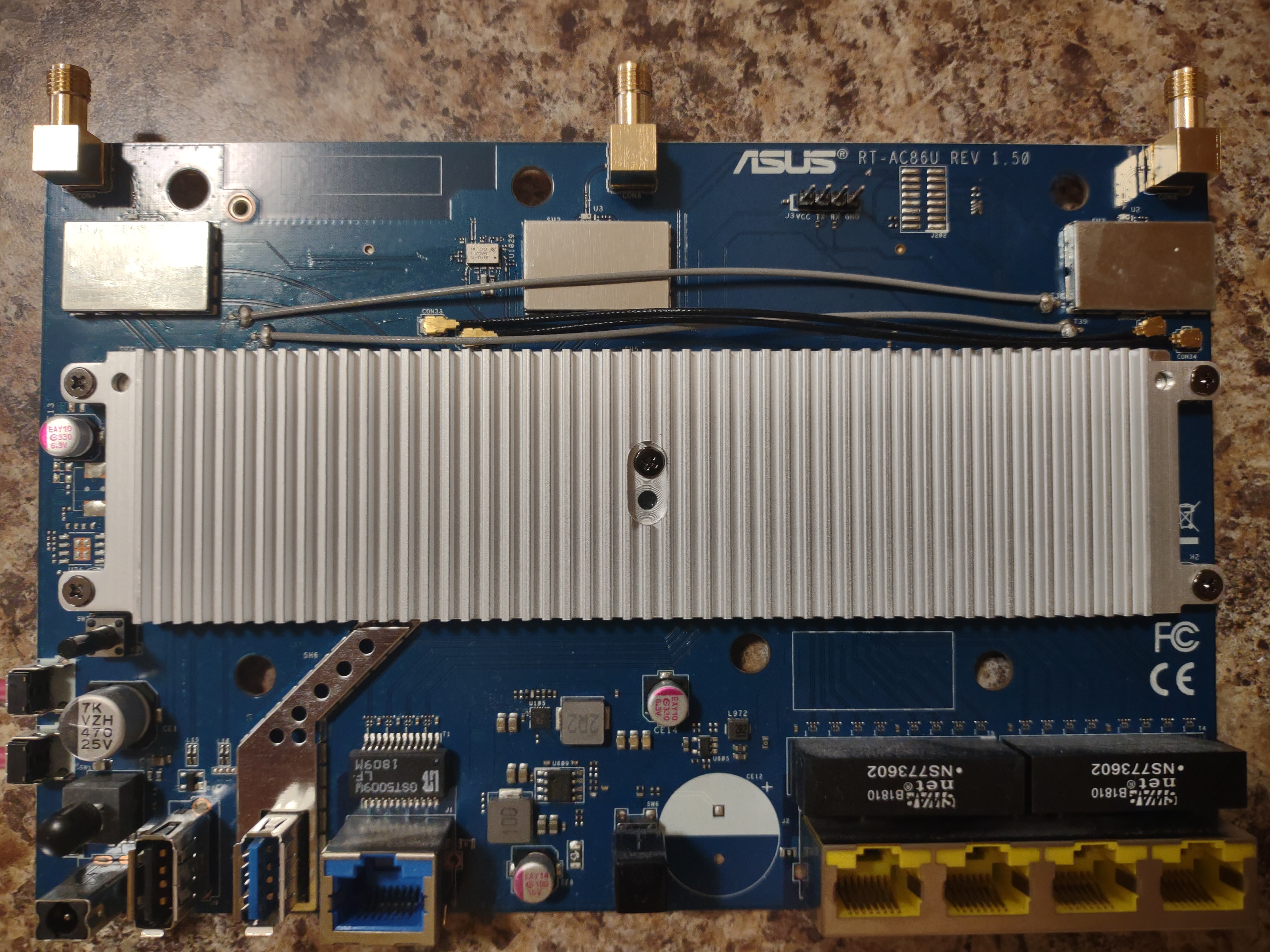

I opened it up and I'm not seeing anything burned or broken using the naked eye. So it's a mystery. I looked over it pretty well too and can't see anything wrong. I tried plugging it in and again only the LAN 5 light turns on and just barely. It's very dim.

Hmm.... much to think on. I'll try looking at the hardware of the RT-AC86U again. Maybe I didn't spot something.

This part looks bad, split top: that 1, does most of the heavy lifting, is closet to incoming power.
If you replace with another surface mount cap, be sure to maintain polarity (bad news if you reverse)

It's a bit hard to see from the picture but that looks normal. Electrolytic capacitors have a cross shape stamped into the top to deliberately create a weak point. So if they explode the contents are ejected out of the top causing less damage than if it exploded downwards or sideways.

The quarter that has the 25V in it looks up. They also can be bit out of spec and all else will fail.

That's what I figured as well. I tried comparing it with others online. (see attachment) It looks somewhat normal to me. I looked over it again but I suppose I can replace it. I don't exactly know what component to use for it.
It doesn't seem to the correct voltage or even specs. I'm reading the following from mine.

Seems pretty close. After viewing the hardware again all over the place I just don't see anything really that stands out as broken, popped or burned.

Did you look at (1) the bottom of the cans and (2) look if swollen off the circuit board?
That picture makes it look normal.
Sometimes you can smell the burnt part.
Don't worry so much about the VZH. Look at temp range and how many hours (5000) it's rated for (hrs bigger is better).
At this point it may be best just to replace the router itself. I was hoping the damage would be immediately noticeable but I just can't seem to find anything anywhere wrong. I'll try sniffing it as well and see if I can smell the burned. I may try to still repair it and give it a go. Worth a shot, but it's seem pretty bleak to me. XD
