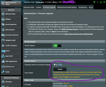

First of all, I completely understand that the RT-AC86U is EOL for Asus/Merlin, but this router still runs solid—except for the fact that it auto-reboots every day.
Ever since update checks have been blocked by the upstream Merlin server, the router has been rebooting at 7:15 PM Central Time daily. I’ve checked everything—from cron jobs and Entware scripts to the web interface for any reboot scheduler—but I can’t find anything that would cause this scheduled reboot behavior.
I read somewhere that if update checks fail, Asus routers might reboot for security reasons. I also cleaned up the /jffs/asd directory and enabled the 'Security Upgrade' option after accepting the Asus privacy policy, but it only reinstated the /jffs/asd files. At this point, I’m not sure what else to try, especially since I have the 'Scheduled check for new firmware' option disabled.
Any ideas on what could be causing this?

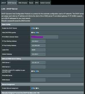

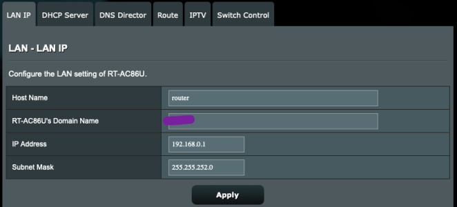

Odd that you’re seeing DHCP renewals for 192.168.1.0/24 IPs when it isn’t a configured range in dnsmasq. How is your network setup?
Why do you have your lease time set for 1 hour? Seems short for the main network. Creates a lot of renewal noise in the log.
There’s nothing obvious in the log. No preceding event, no crash dump after the reboot. Maybe power related, but odd that it happens at the same time every day. No outlet timer anywhere?
Lease time is set to 3600 for long time, I think I lowered it long back from 24 hrs for some static IP conflict in past. Nevertheless, I have changed it to 86400. We will see if that has anything to do with reboots today.
As far as outlet power is concerned, I don't have any timer attached to it. Also please note that any moment my WAN port power goes down, I get a new WAN IP from my ISP. During the reboots we are discussing, no WAN IP is changed, so I assume that WAN port is always up.
My network is '192.168.0.0/22' out of which '192.168.0.0/24' is for DHCP, see the attached images. I use '192.168.1.0 - 192.168.3.254' is for static assignment via web interface (from 192.168.1.0/24), for guest network (192.168.2.0/24), and for underlying Kubernetes/ MetalLB (192.168.3.254). Kubernetes and Guest network is not live as we speak, so only 192.168.1.0/24 is being used outside DHCP for static assignment to my wired devices.
