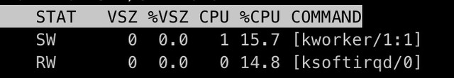

During the download I opened a top in a SSH shell and i noticed that the top 2 processes are:
But, is it normal, isn't it?
