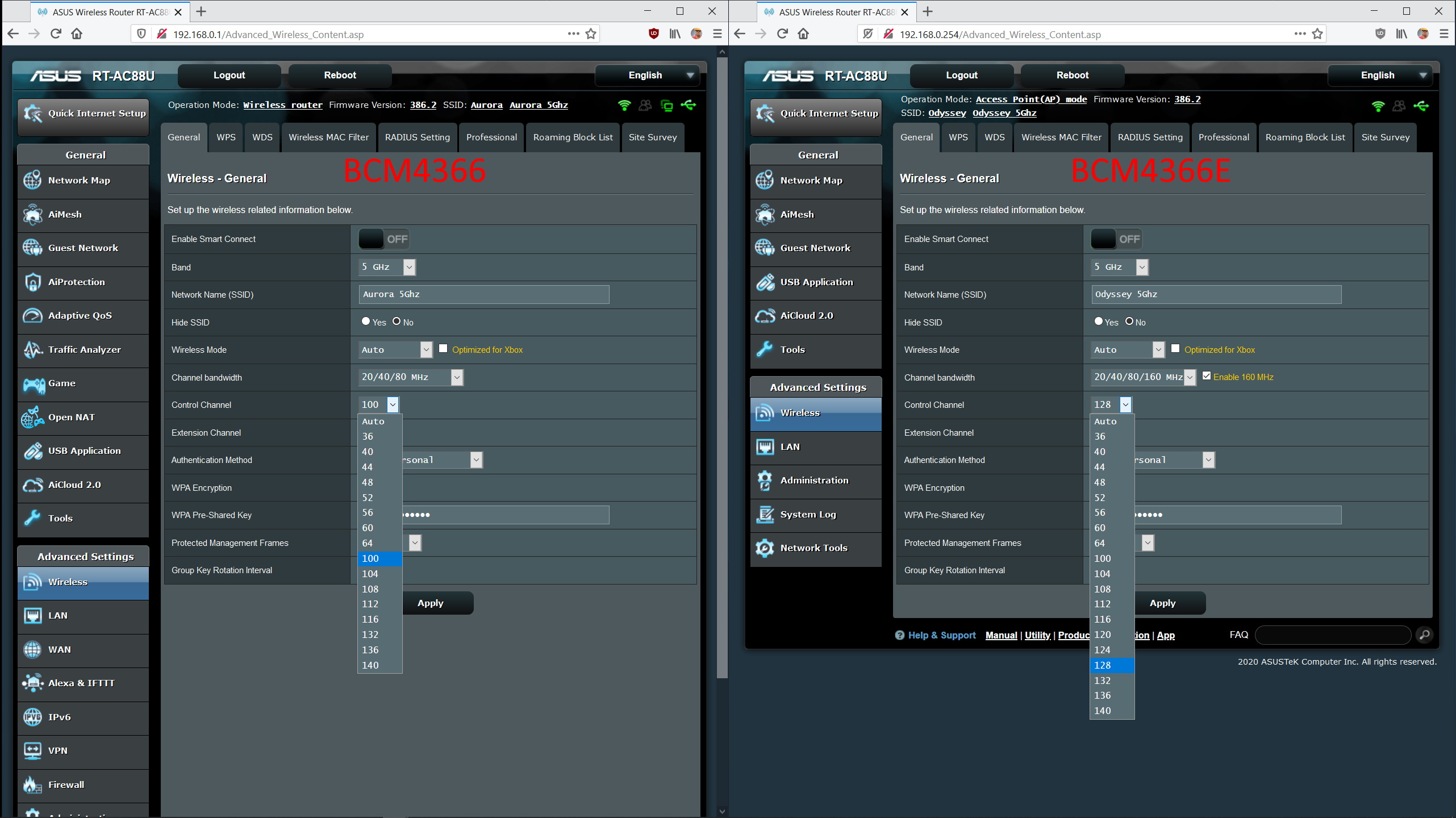

UK/EU models with BCM4366E support 160 MHz & 36,40,44,48,52,56,60,64,100,104,108,112,116,120,124,128,132,136,140
UK/EU models with BCM4366 support 80 MHz & 36,40,44,48,52,56,60,64,100,104,108,112,116,132,136,140
Asus added support in 386 for the BCM4366E variant no idea why they didnt add 120,124,128 for the BCM4366 variant
Merlin has fixed support and it will work in his next release

Yep, we troubleshot it through irc. Thanks for the model breakdown because we were wondering about it.

Looks like 386.2 alpha1 (Feb. 9. Release) comes with a fix to enable the 160Mhz channel. If you're brave enough to install the alpha you can test it out to see if the fix works.
