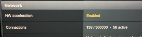

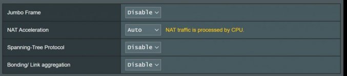

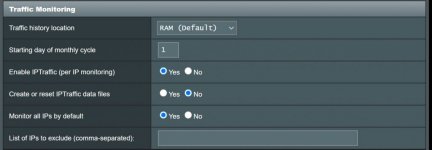

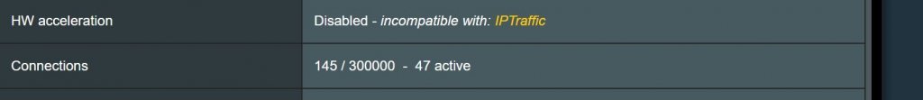

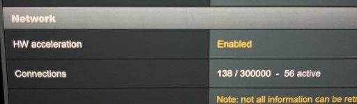

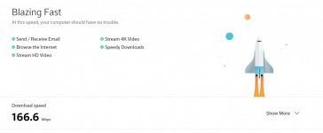

fach
I revert to original setting and wifi speed when to single numbers. I guess my router does not like hw acceleration.
