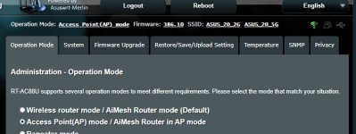

Wifi radio is enabled , but does not work. Control channel shows 0 or auto. (Both 2.4 and 5ghz).
I have reset the router, tried asus stock firmware, and merlin too. Same issue in both the firmware.

hi R. Sadly that did not work either. I got this from a friend who said " router does not work" i got it with just power light going on and nothing else happening. Then I reset and got to cfe mini web page, used asus firmware restoration tool and installed stock asus FW. In that too could not see the wifi, then i installed Merlin 386.9 . still no go.
In the Site Survey Tab in wireless setting shows this. the 2.4 GHz radio is disabled - cannot scan that band! 5 GHz radio is disabled - cannot scan that band!
i still believe it is something else. i see mac ID for the 2.4 ghz. wireless webpage is broken.

If even after a reset the wifi don't work, then it`s definitely defective.
If the models listed here has a BCM4366 WiFi-module, it is not that uncommon that these chips just die.....
