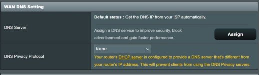

Hello. How do you disable DNSSEC? I could not find it on the router setting. Please help. Thank you.
It's an option under WAN DNS Setting. The option is not present in stock firmware.
Thank you for your prompt reply. Yes, currently still using stock firmware. Is that means that DNSSEC disabled by default?
I wonder sometime the router is not able to assign our devices the correct IP address (it gives 192.168.1.xx instead of 192.168.50.xx). So devices won't be able to connect to internet.
Stock firmware doesn't support DNSSEC at all.
This has nothing to do with DNS. Although I see you are overriding your router's DNS server with different ones in the LAN DHCP settings. That's usually not a good idea.
It sounds like you have another DHCP server on your LAN. This is often another router, access point, repeater, etc. that has configured or connected incorrectly.
