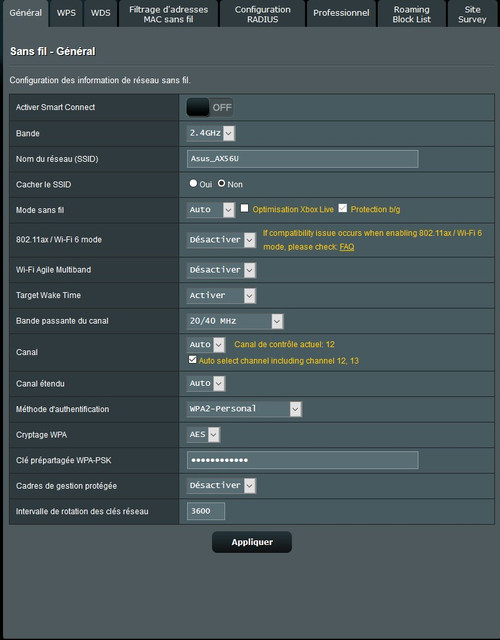

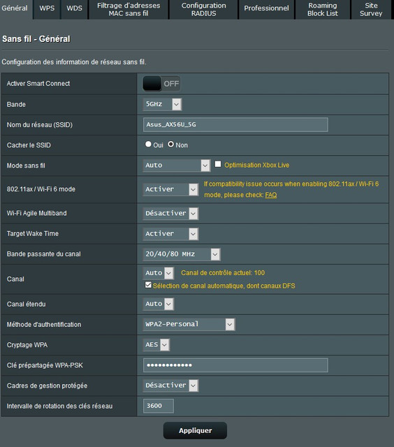

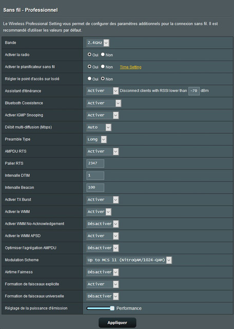

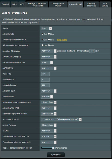

My configuration page :
Thanks in advance for your help.

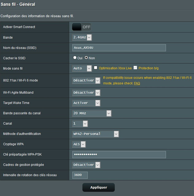

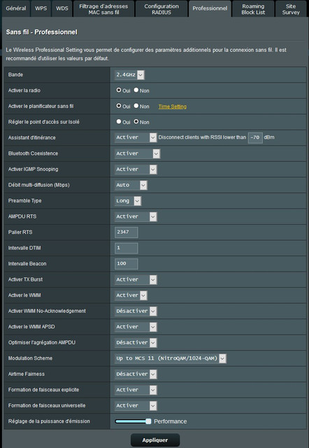

I´m not an expert, but I would try to disable the option to selection channel 12 & 13. Some devices may not be too fond of these I believe. Also - maybe try a fixed channel (1-11).
Do not use Auto Control Channels for either band (eventually, you'll have issues on both). Use 1, 6 or 11 and 20MHz bandwidth for the 2.4GHz band. Use non-DFS channels for the 5GHz band with 20/40/80 MHz bandwidth.
Disable Universal Beamforming. Disable Airtime fairness.
I would also suggest an 8 alphanumeric character SSID with no spaces, punctuation, special characters, or smiley faces. The password the same except for 16 characters long too.

I don't know when the problem appears but I've always activate time settings to stop the 2 wifi networks at night. Perhaps the problem appears at the time of reactivation. I am with a second router for Aimesh.
As you can see I have changed the parameters as recommended by @L&LD
Thanks for your help
