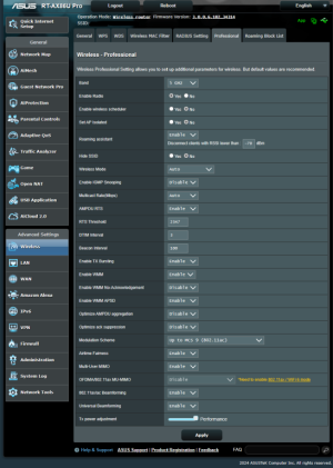

Post readable screenshots of your router's WiFi General and Professional pages, redacting any sensitive information, so others can see what your settings are.
PS: Also post your firmware version on the router as I don't see it (unless I missed it) indicated in prior posts.

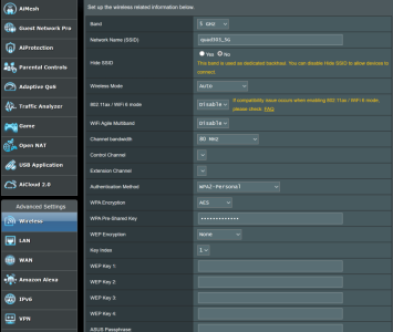

Okay. Now that's interesting. This time it did connect using the N band with decent speed. However the Asus interface changed to dual 5Ghz and 2.4Ghz. And although the channel changed to 36, there is no longer the ability to change it. That's a different interface. I saw this before and had to reset the router to get the normal interface back. Unless you have some idea. Thanks.
Firmware is 3.0.0.6.102_34314-g8ae1379_400-g562af. See the previous replay. I can't get the normal interface back now without resetting. Reinstalling the firmware doesn't help.

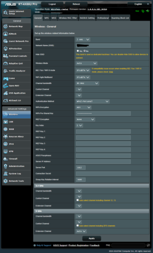

Note that the General Settings page changed for some reason.
That page is completely corrupted. You shouldn't be seeing many of those options. That sometimes happens when one of the radios has stopped working (i.e. a hardware fault). Try removing the power and waiting a minute before turning it back on.
