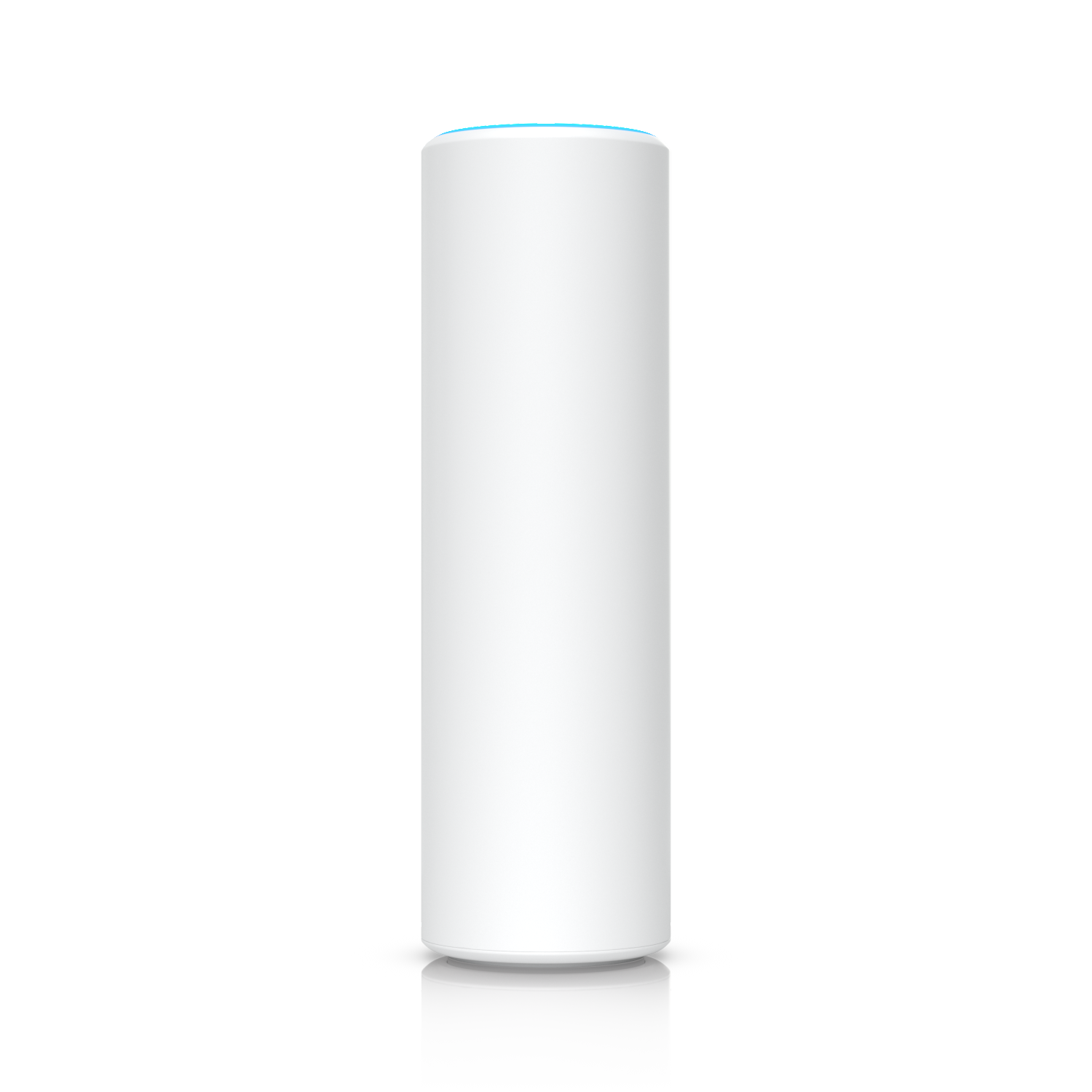

My UniFi U6-Mesh APs have similar range to RT-AX86U. I have 4x APs though running on low power (100mW or 20dBm). Power over 400mW or 26dBm is mostly increasing the environment noise since the range becomes more defined by the clients with their 12-14dBm radios. What you perceive as great Wi-Fi will be assessed as Poor in Ubiquiti UniFi due to highly disbalanced Tx/Rx links to clients.

Correct, but your RT-AX86U Pro doesn't have better antennas. They are low-gain 2dBi dipole about 5cm long and all the rest is non-functional plastic. U6-Mesh have higher gain 5dBi internal antennas, for example. The client can hear a loud high-power AP, but may not be able to reply back. Wi-Fi is 2-way communication. This is where range limitation comes from.
