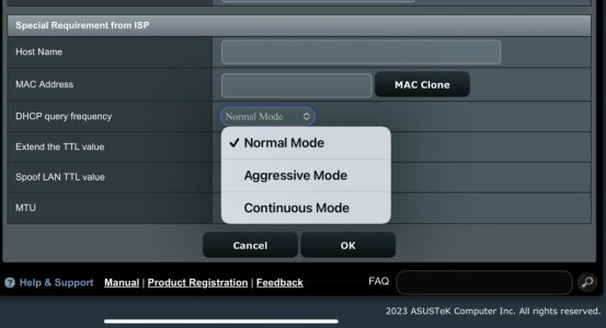

On another note, make sure your WAN DHCP settings are on Normal mode not the default Aggressive mode. I have found the default aggressive mode can cause issues.
Yeah it's set to Normal.
