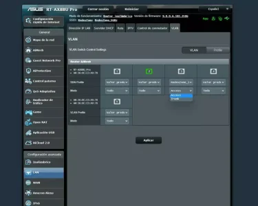

with the normal asus router software I can add vlans with the GUI. See image attached.
My question is now, if I have the same GUI with all options when I install Merlin. I read that merlin have all the normal software have and more. So the vlan GUI should be there, when I install Merlin, right?
Because I want to create a VLAN for my IoT devices and I want to use the GUI for this. It is possible with the AX88U Pro to create a VLAN only for IoT devices, right?

No. Merlin's firmware for your model is currently based on the older code base that doesn't have VLAN support. This question has been asked many times. Use the search function to see those posts.

But thank you, then I need to use the original asus firmware. Is it planned to use the new code base soon?

RMerlin stated yesterday that he's still waiting for the new codebase to become mature enough to use. Don't hold your breath, because even when that happens there's usually a fairly long development cycle.
