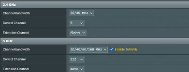

160 MHz is enabled. Manually set the WiFi Channel to 112
  • Screenshot 2021-05-31 at 00-05-49 ASUS Wireless Router RT-AX88U - General.png
