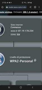

Here my wan ip.
Use that as your static address and see if you can connect to the ONT and test speed directly with your pc
