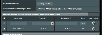

I believe the following options should work for you.
