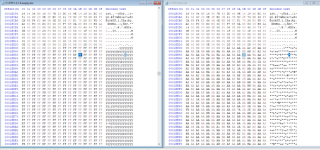

Does anyone have a backup CFE from a 1.0.1.9 they could share?
I compared the Ryzhov one with another 1.0.1.9 from a N66U I have, and they have huge differences. The version string in the CFE is the same. It hardly makes sense that the same version would have vastly different code.
this is my version: "CFE 5.100.138.20 bl_version=1.0.1.9"
and the Ryzhov empty one: "CFE 5.100.138.20 bl_version=1.0.1.9"
See the attached, where Ryzhov has a massive empty block, while mine has code there. My router has done strange things recently, so I'm trying to figure out if I have a clean version, or somebody has modified it.

I think I figured it out. After a certain point, at at a spot in the PNG I attached, the CFE ends, and it's just garbage after that. I wanted to make sure the CFE wasn't messed around with because the router's DHCP kept freezing up once connected to the modem, .. I did the comparison and it was nearly identical up to that point. I took the CFE and erased the garbage and re-flashed it.. and it booted even with it erased, so it is just random data. After I reflashed Openwrt though, my Laptop froze, firefox disappeared, and after replacing the SSD with a backup, with no network connected, the Firefox profile disappeared, and I got some Windows errors.. So I'm throwing the router out .. and I'm not even sure what to do about the laptop. Looks like I should've just bought a new router rather than play with hex editing and flashing stuff. I need a very secure isolated VLAN router now.

CFE editor is not showing allow, just same values you can edit. If you remove same part of it that looks like random code you are done :(. You can find file CFE_AIO.zip file online that have all Asus old CFEs.
