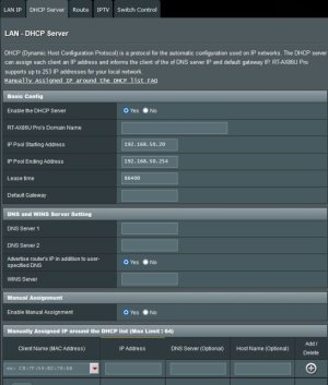

What you are experiencing is normal when manually assigning an IP address. The solution is to assign a static IP address at the client.
Sorry maybe I was not enough specific. I am not manually assigning an IP address. I am just, as you suggested, trying to make the current IP address a static DHCP lease. Take a look at my example screenshot, what I mean is that the WAN connection gets dropped whenever I activate that 'toggle' indicated by a red arrow in the image.
All in all, I would not even mind that much this happening, if the connection were to be dropped for a few seconds, or even a minute. But the connection does not seem to come back for an uncomfortable amount of time (I usually resort to rebooting the router, which is faster).
Yes, you were manually assigning an IP address. Static IP addresses are assigned at the client. Manually assigned addresses are assigned by the DHCP server which in this case is the router. The DHCP process has to be restarted each time a client is manually assigned an IP address. See LAN/DHCP Server.
MAC and IP address binding is another way to say manually assigned. Confusing, I know, but the folks who program these things do not stop to think about keeping terms consistent.
