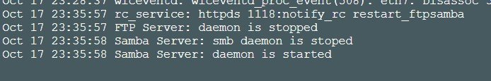

Hi, attached are the screenshots. The last entry in syslog is that the smbd daemon is apparently started.

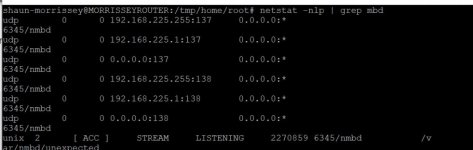

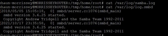

I do have SMBv1/CIFS client enabled on my Windows 11 desktop as mentioned. Attached is the output of first command, second command returns nothing, 3rd command also (attached) and last command also attached.

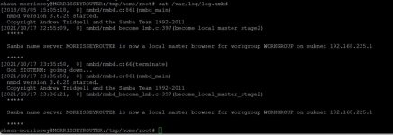

Thanks. So that confirms that nmbd is running OK but smbd isn't. My guess is that there's a non-alphanumeric character in the config file that Samba is choking on. Can you post the complete output of cat /etc/smb.conf, preferably as a text file rather than a screen shot.

My last idea is to look for smbd errors in the syslog files:
grep smbd /tmp/syslog.log*

shaun-morrissey@MORRISSEYROUTER:/tmp/home/root# grep smbd /tmp/syslog.log*
Oct 17 23:07:40 rc_service: service 3271:notify_rc start_smbd
