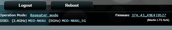

I have an N66U repeater with John's 49E4 and tried today schedule reboot from the GUI. I notest that the reboot is very "soft", is lasts no more than 15 seconds, while the 'Reboot' buttton lasts more or less 2 minutes. What's the difference between this two reboots? The schedule reboot does not solve my issue with the router, which is an Android 11/One UI 3.1 battery drain, but the 'Reboot' button does though I have to reboot the router every 24 hours. I don't know if this is important but I reboot the router through my phone browser and it's annoying having to do it every day, I don't know if that even harms the router! Anyway, can the schedule reboot being changed to reboot as the 'Reboot' button does? Or is there another alternative to reboot the router on a daily basis, but a "complete" reboot? Thanks!

There is no reboot button.
