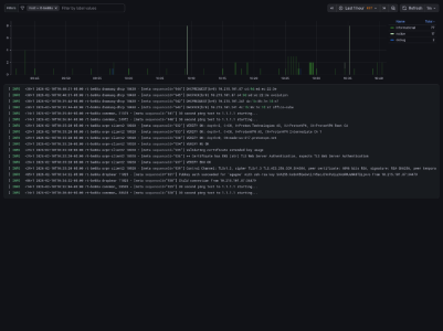

I placed my syslog server settings in /opt/etc/syslog-ng.d/loki-syslog-server.
This was working ok with the exception that some of the filters where no longer working.
After rummaging around with scribe cmdline ui and using the lc option to show the loaded configuration. I noticed that
the files are loaded in alphabetical order. A rename of loki-syslog-server to z-loki-syslog-server followed by a re-start of
syslog-ng had everything working correctly again.

Interesting. Did you try the native Loki() destination and template?
No, I cobbled together the destination and template as well as a few rewrite rules necessary since some
of the router services like to output null fields.
