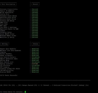

I installed the Developer version of Scribe over the regular Scribe to see if it would resolve the issue I’m having, but I still can’t get the Skynet GUI stats to display in the router interface.
I’ve uninstalled both Scribe and Skynet multiple times and removed all traces of them, but the Skynet GUI stats remain blank every time.
My setup:
  • Firmware: Merlin 3006.102.5
  • Add-ons: Diversion, Skynet, Scribe, UIScribe

Scribe doesn't affect the Skynet GUI. Which version of skynet? Which blocklist? What does the Skynet log say on the System Log page?

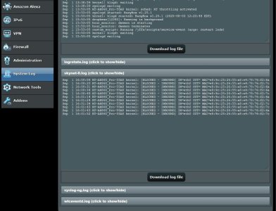

On the System Log page everything looks normal. No errors or anything like that. Skynet is in it's own tab.
Here is the info you asked about:

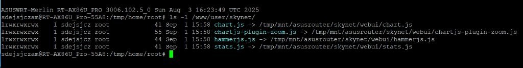

The attached image show whats in: /www/user/skynet/
When I hit the Update Stats button inside the routers GUI, it tells me to wait while it attempts to generate stats. When I run run firewall debug genstats, I get a message on the screen that says: Generating Stats.
