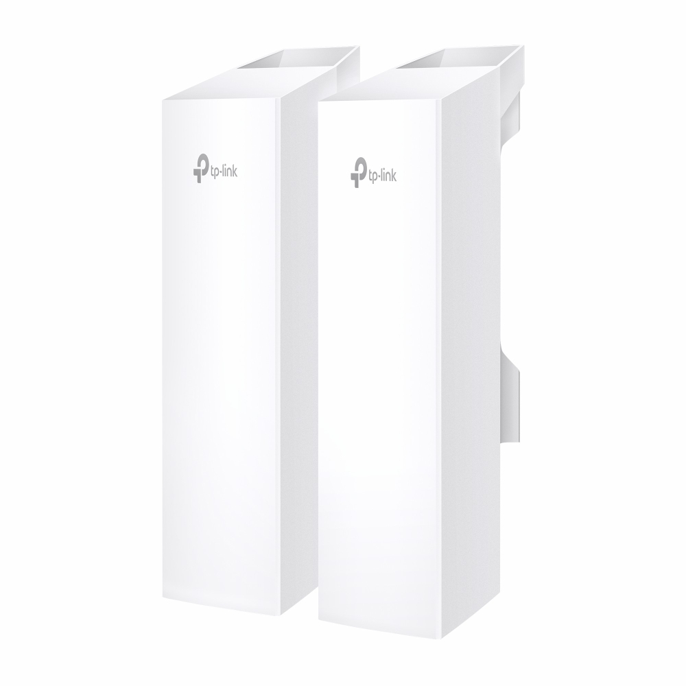

TP-Link EAP211-Bridge Kit is currently $115 on Amazon US. Perhaps cheap in other regions too. At small distances will do full speed link and each unit has 3x Gigabit LAN ports. May come significantly cheaper than digging for any type of wires, provides electrical separation and can be up and running literally a day after the package arrives with no need for additional hardware.
