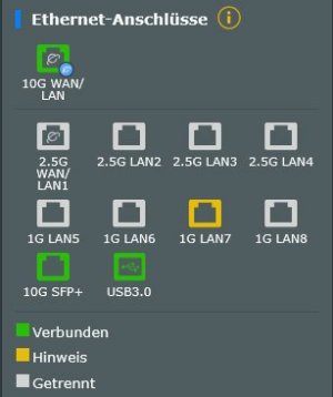

can confirm that you are using the SFP+ port on the BE88U router configured as dual-WAN or otherwise? your Asus card is on a pcie slot on a computer?
Currently, I'm using the SFP+ port of the BE88U router, which is directly connected to the Asus card. The card is on a PCIe slot.
