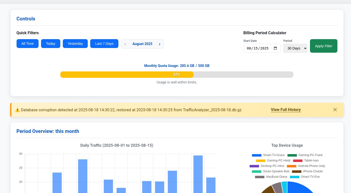

Hello guys,
I have been working on something for 3 months nearly everyday to make the best possible solution...
and it's time to share it with you, the name I used for personal use was Superman but it's now changed to Superhero
I'm not a professional developer but certainly for a tech-driven person there were a lot of small details and effort behind the scenes to achieve decent quality
SkyHero v2.0 shell based script ---> published for research and as a sign of progress
SkyHero v2.1 python based script ---> superior in every way & ready for use
why it matters?
* the Traffic Analyzer feature that Asus routers have is very unstable and often gets wiped at random times, which makes it far less useful than it should be.
* this script saves and organizes the data, and even provides additional stats to help monitor traffic usage.
what do you need?
Asus router with Asuswrt-Merlin firmware and entware installed on an external USB
key features:

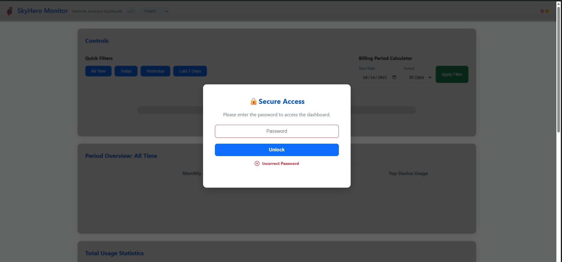

- you get lightweight dashboard with separate url showing all important stats, with optional password lock.
- strong architecture that copies db records from router to an independent smart database saved project then archived into json periods files & backups
- you don’t start with zero data but all available historic data gets imported from your router and utilized.
- self healing that meant to restore internal ASUS database if it matters to you but it's disabled by default
- quick buttons to filter data based on All Time Today Yesterday Last 7 Days ‹ months navigator ›
- visual quota usage progress bar that shows current traffic usage status daily/weekly/monthly periods
- period overview that shows line bars for the selected period based on days/hours
- a pie-chart that shows 10 top Device Usage instead of the limited 5 that Asus offers
- billing period calculator , know exactly the usage based on your intent bill time

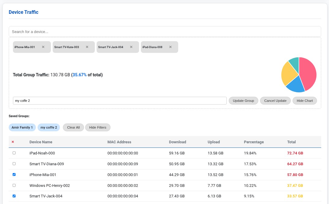

- table view showing per-device usage with warning color indicators and search bar.
- smart groups that can be saved to mark couple of devices and see their total usage and compare
- desktop mainly yet mobile is fully supported.

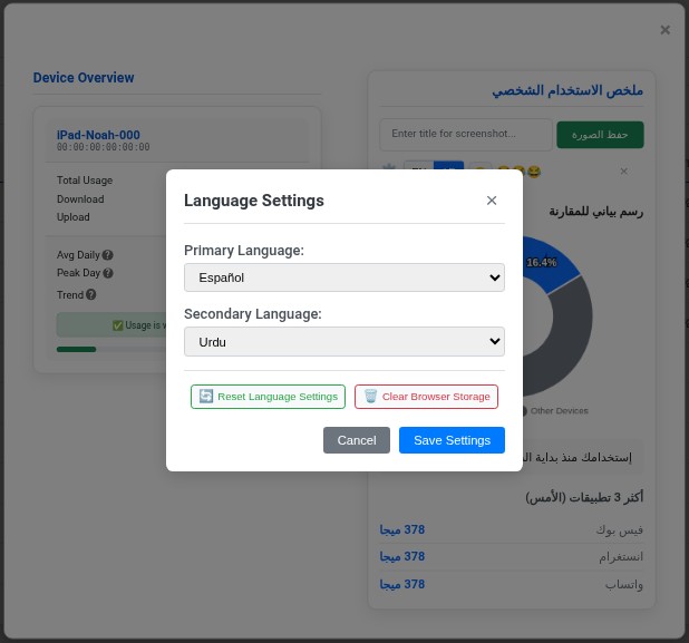

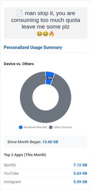

- device screenshot for a personalized usage summary two layouts "my favorite feature"
- the script supports multi langs but mainly English/Arabic
- new metrics like avg/peak day with Tooltips that explain each one
- stylish CLI menu to manage the entire system like password, quota, server restart and db info etc.. shortcut access type "skyhero/skyhero2"
- autostart mechanism to allow script to work after power loss or router restarts, in addition to an improvement to the USB mount handling as a bonus
where is your data and how to keep it safe?
The easiest and safest way is to copy the "data" folder It contains json files / traffic.db can hold as long record of data as you wish and it's the file that generate json file it is taken as backup and it can be used to restore router database if lost though not yet tested for that purpose / there are also built-in backup options in "Skyhero menu Cli".
unlikely but in case any problems occur during use, from the skyhero menu consider these options:
use 9) Restart Python Web Server if there’s an issue with the web side. / try 3) Run Manual Traffic Grab if data seems off. / or use the ultimate fix: 1) Install / Update, which refreshes everything.
tested routers so far, please share your feedback too?
RT-AX58U V2 ... working with no problems
