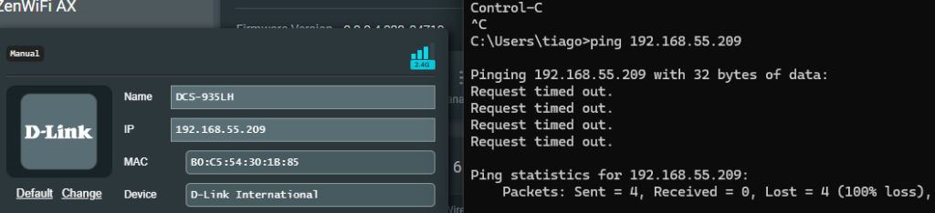

it gets to the point that even router show device as conected i cannot even ping them until i reboot the nodes
