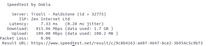

I just noticed that the QoS page of my new AX88U has a speed test, don't think my old AC87U had this.
Anyway I thought this would be the best speed test as it's on the router, but it's showing almost half my connection speed.
Anyway my FTTP connection is sold as 900/100 and via command line speedtest.net (PC via Ethernet) I get 910-920 Mbps down and 100-110 Mbps up - which is what I would expect.
But the built in test doesn't exceed 600 Mbps, is this expected?
It's odd the router has a rating for speeds over 900, leading me to believe it could test to that speed. Maybe it can't.
