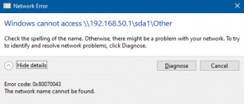

I can connect to the HDD share remotely with both my MacBook as well as Solid Explorer on my Pixel after putting in the login/password. When I try to connect with Windows using the IP address, I get an error attached as an image
What else can I try for Windows to work (if I wish to keep SMB2 and login/password)

It didn't work (see attached). I also tried it on another folder within another drive labeled with my name (instead of sda1) - same issue. Funny thing is the moment I turn on "allow guest login" it works perfectly fine. I also no longer get the original error about "network mapped with another username"

You need at least one folder on the USB drive as a directory folder like John9527 mentioned setup in the Samba tab
Not that I know what it was like before or why it is why it is, but... the share name is tricky
You could run below in SSH to find your usb disk share name under /tmp/mnt/
df
Or just run
cat /tmp/etc/smb.conf
Near the bottom the share name is in the [ ] brackets
You can try in Windows exactly as below.
\\192.168.50.1\foldername (at usbstickname)
Hopefully that works...
I personally had to use a smb.postconf script to edit the router samba share name from 'foldershare (at usbstickname)' to 'foldershare' to get it to mount on Debian which was easier than trying to format it for fstab

Ding! Ding! Ding! \\192.168.50.1\foldername (at sda1) was the answer for Windows 10 PC! Thank you so much - this issue is now resolved!
