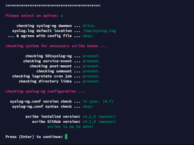

I've been diagnosing this issue for a while now trying to troubleshoot as much as I can to provide as much details as possible. I've seen similar issues in other threads that I could relate to, but I need some more assistance to decide what is the best fix for my issue. It might get useful again for the whole community if it turns out that we need a global config check built into the original script.
I had my DSL-AC68U previously running on firmware 386.12_0-gnuton0_beta1 (latest beta back then) setup with the latest scribe 3.2.0 and syslog-ng 4.7.1, and it was running smoothly without any issues at all.
A couple of months ago, I setup my DSL-AC68U again from scratch but this time with firmware 386.12_0-gnuton1 (latest release right now) with a slightly different setup. Additionally, I added my RT-AC68U again to my home network, setup with the latest official Merlin 386.14. Both my routers right now have the latest version of all addons, scripts, and packages (amtm 4.9.2, scribe 3.2.0, syslog-ng 4.7.1), and they both have the exact same issue!
Now, straight to the point. At the beginning, I noticed some intermittent loss of logging, and as I have my own reboot and shutdown scripts that does my own stuff, I noticed that a lot of times syslog-ng fails to shutdown properly as a service using command "/opt/etc/init.d/S01syslog-ng stop", which might very likely mess logging on the next boot up, so I have to make another reboot to sort things out again!
So, I started by trying to restart the service manually outside my own scripts using the command "/opt/etc/init.d/S01syslog-ng restart", and the same issue happens, syslog-ng frequently fails to shutdown, then it keeps consuming 49.9% of the router's CPU until I kill it using the service kill command "/opt/etc/init.d/S01syslog-ng kill". Again, it messes logging most of the times and I have to reboot the router.
Next, I uninstalled scribe completely, then installed it again as normal, knowing that all scribe status checks are ok before and after the re-installation process, but the problem persisted with syslog-ng frequently not shutting down gracefully. And to make sure everything is done right, I did all of this more than four times!

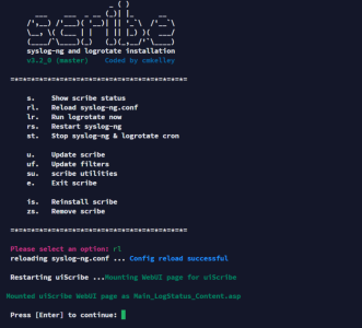

I'm away from my routers so it will take me a bit to unpack all this, but I suspect at root the problem is that scribe isn't set up for syslog-ng to be started/stopped through rc, and your custom start/stop scripts are adding to that. When scribe starts or restarts it kills the daemons and starts syslog-ng; when it stops it needs to stop syslog-ng and restart the daemons, and I don't think the .func helper does that. Those two sources are the ports the daemons serve to syslog, which I think is why you see them in the mix. But I'm not sure.
Yes, you are probably on the right track — there is an option (rs.) within the scribe interface to restart syslog-ng:

First of all, thank you very much for your interest in helping me to troubleshoot and solve this out.
