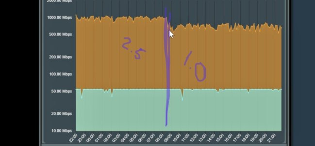

When I switched the Ethernet cable on the access point fron the 2.5 port to the 1.0 LAN port, the Speer tests decrease.
I get that.
What’s limiting the speed when the access point uses the 2.5 gbe port?
I get that.

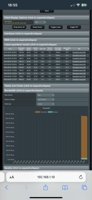

So today I bought a new rt-88u pro router
I set it up in AP mode.
It generated good results 1800-1900 mbps connected through two switches using a 2.5 gbe back to the main router, another rt-ax88u pro.

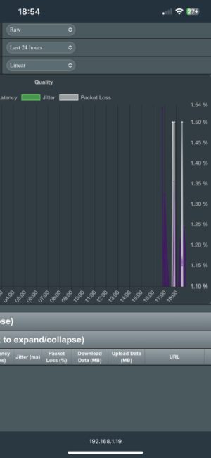

Packet loss was 1.5 percent, but that’s ok considering I’m using cat5e cable in my office/home.

You should have 0 loss at 2.5 gig over Cat5e, so you need to look at your physical cabling and connectors. 1.5% packet loss can have a significant impact on throughput.
